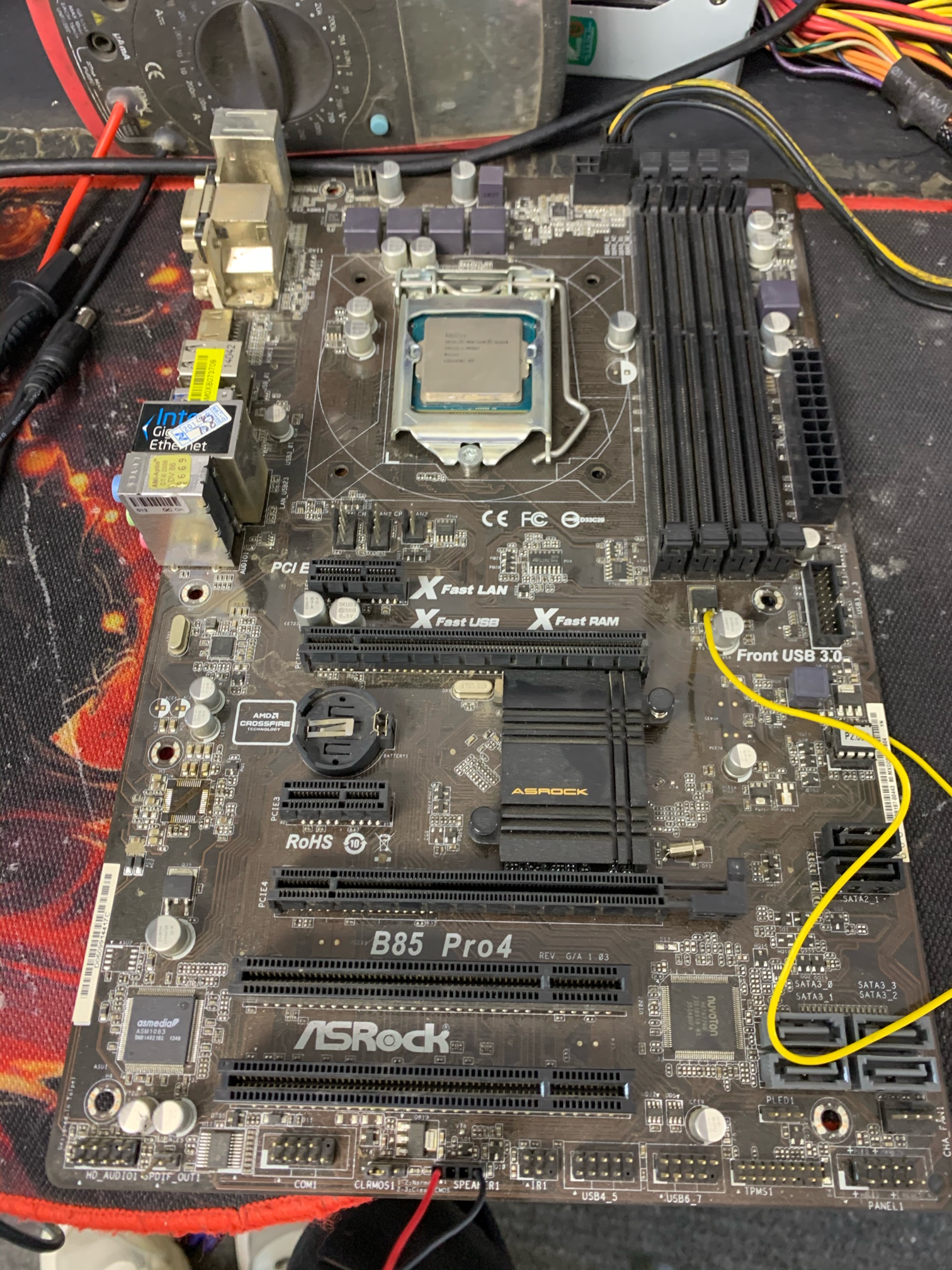

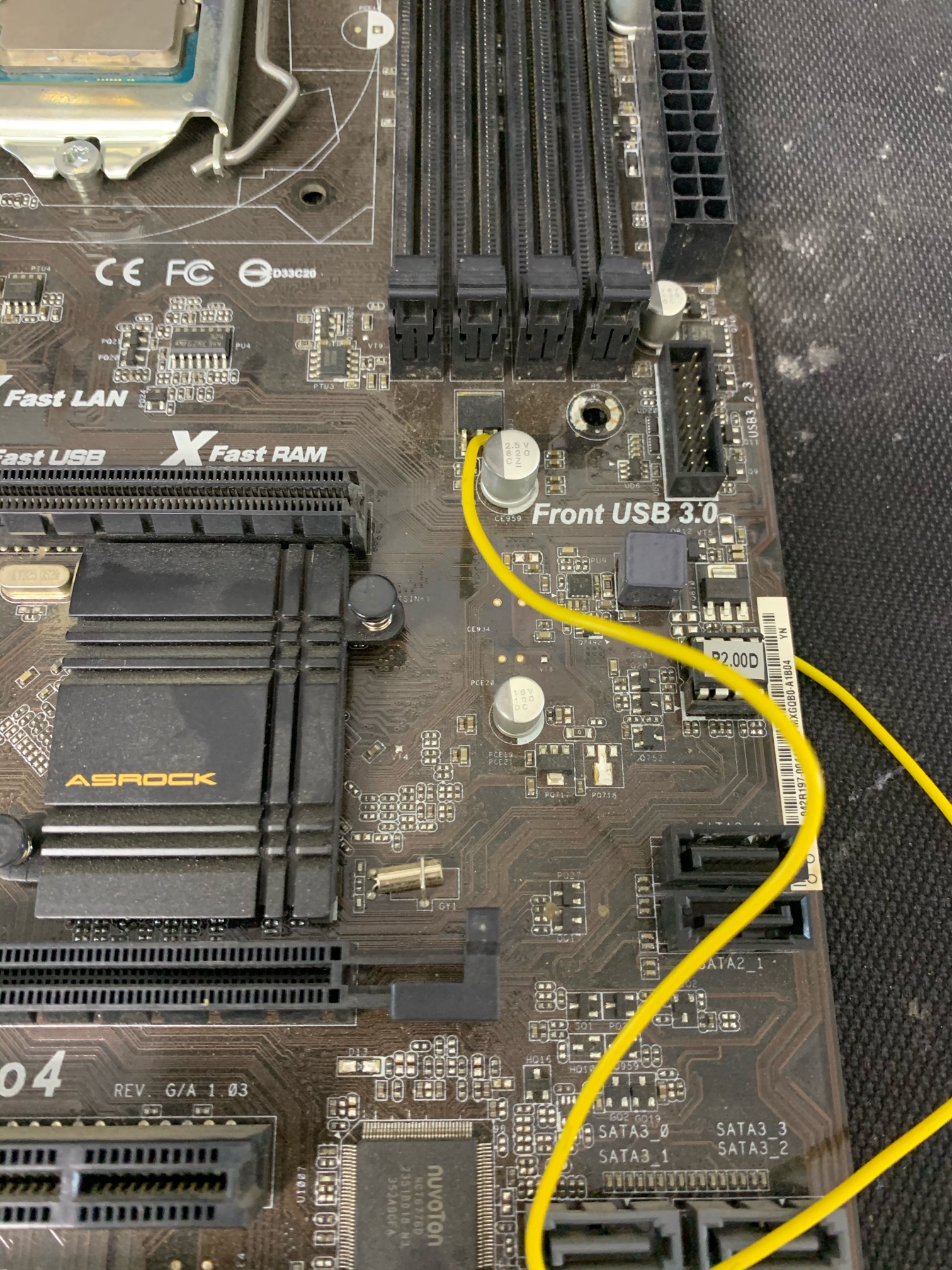

»ªÇæ B85 PRO4 Õâ¸ö°å×ÓÓÐÒ»¸öͨ²¡¾ÍÊÇ ÇŹ©µçûÓÐȱÉÙ1.1V £º½â¾ö·½°¸£º·ÉÒ»¸ö1.1Vµçѹ¸øµç¸ÐÉÏÃæ¾ÍÐÐÁË£¬
   1.ͨµç£¬ÊÖÃþcpu²»·¢ÈÈ£¬ÍòÓñí²âÁ¿ CPUÎÞ¹©µç£¬Äڴ湩µç1.6£¬ÇŹ©µçÎÞ
  2.Ä¿²âÎÞ¶ÏÏߣ¬¸¯Ê´£¬²âÁ¿ÎÞ¶Ì·£¬ °´ÕÕͨ²¡À´ÐÞ£¬·ÉÒ»¸ö1.V¸øÇŵç¸Ð
  3.ͨµç²âÁ¿ÇÅ1.1V¹©µçÕý³££¬cpu¹©µçÒ²³öÀ´ÁË
  4.ÏÈÄÚ´æ-ÄÏÇÅ-cpu¹©µç˳Ðò£»ºÜ¶àÎÞcpu¹©µçµÄ£¬ÏÈÐÞ³öÀ´ÄÏÇŹ©µç
  5.²åСÀ®°È£¬»úÆ÷²»ÅÜÂ룬¹©µçÒ²Õý³£
  5.°ÑÉù¿¨Ð¾Æ¬´µµô¾ÍºÃÁË¡£

·¢±íÓÚ 2020-10-17 09:58:05 | Ö»¿´¸Ã×÷Õß À´×Ô£º ¹ãÎ÷ÁøÖÝ À´×Ô ¹ãÎ÷ÁøÖÝ
´µµôµÄ²»ÊÇÉù¿¨Âð
µãÆÀ
¿´×ÅÄǸöλÖ㬲»ÊÇÍø¿¨£¬È·ÊµÊÇÉù¿¨£¬£¬£¬  ÏêÇé »Ø¸´ ·¢±íÓÚ 2020-10-17 11:37
3#
·¢±íÓÚ 2020-10-17 11:37:53 | Ö»¿´¸Ã×÷Õß À´×Ô£º Öйú À´×Ô Öйú
1210351965 ·¢±íÓÚ 2020-10-17 09:58
´µµôµÄ²»ÊÇÉù¿¨Âð
4#
·¢±íÓÚ 2020-10-17 12:01:27 | Ö»¿´¸Ã×÷Õß À´×Ô£º ÉÂÎ÷ À´×Ô ÉÂÎ÷
άÐÞ˼·ºÜÇå³þ£¬¾ÍÊÇ¿ÉÄÜ¿ÚÎ󣬰ÑÉù¿¨Ëµ³ÉÁËÍø¿¨¡£
µãÆÀ
´ò´íÁË¡£¸Ä»ØÀ´ÁË  ÏêÇé »Ø¸´ ·¢±íÓÚ 2020-10-17 13:47
5#
·¢±íÓÚ 2020-10-17 13:47:15 À´×ÔÑ¸Î¬ÍøAPP | Ö»¿´¸Ã×÷Õß À´×Ô£º Öйú À´×Ô Öйú
zhubaoyouwo521 ·¢±íÓÚ 2020-10-17 12:01
´ò´íÁË¡£¸Ä»ØÀ´ÁË
