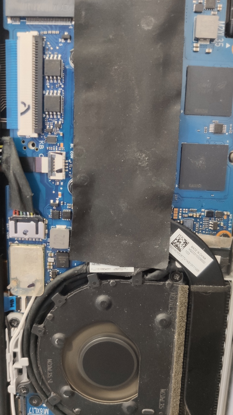

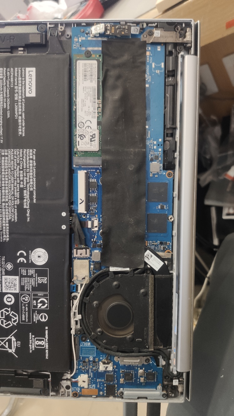

thinkbook 13x ²»Éýѹ  »»ÁËС°åºÍÅÅÏß¶¼²»ÐУ¬×îºó·¢ÏÖÎÊÌâÊdzöÔÚtps65994ÉýѹоƬÉÏ£¬»»ÁËtps65994²£Á§ÉýѹоƬ֮ºó£¬»Ö¸´Õý³££¬ÄÜÕý³£³äµçÁË£¬´ó¼ÒÓÐÓöµ½ÀàËÆµÄÇé¿ö¿ÉÒÔ¸ü»»´ËоƬÊÔÊÔ£¬²£Á§Ð¾Æ¬£¬ÔÚÆÁÏß½Ó¿ÚÅÔ±ß
