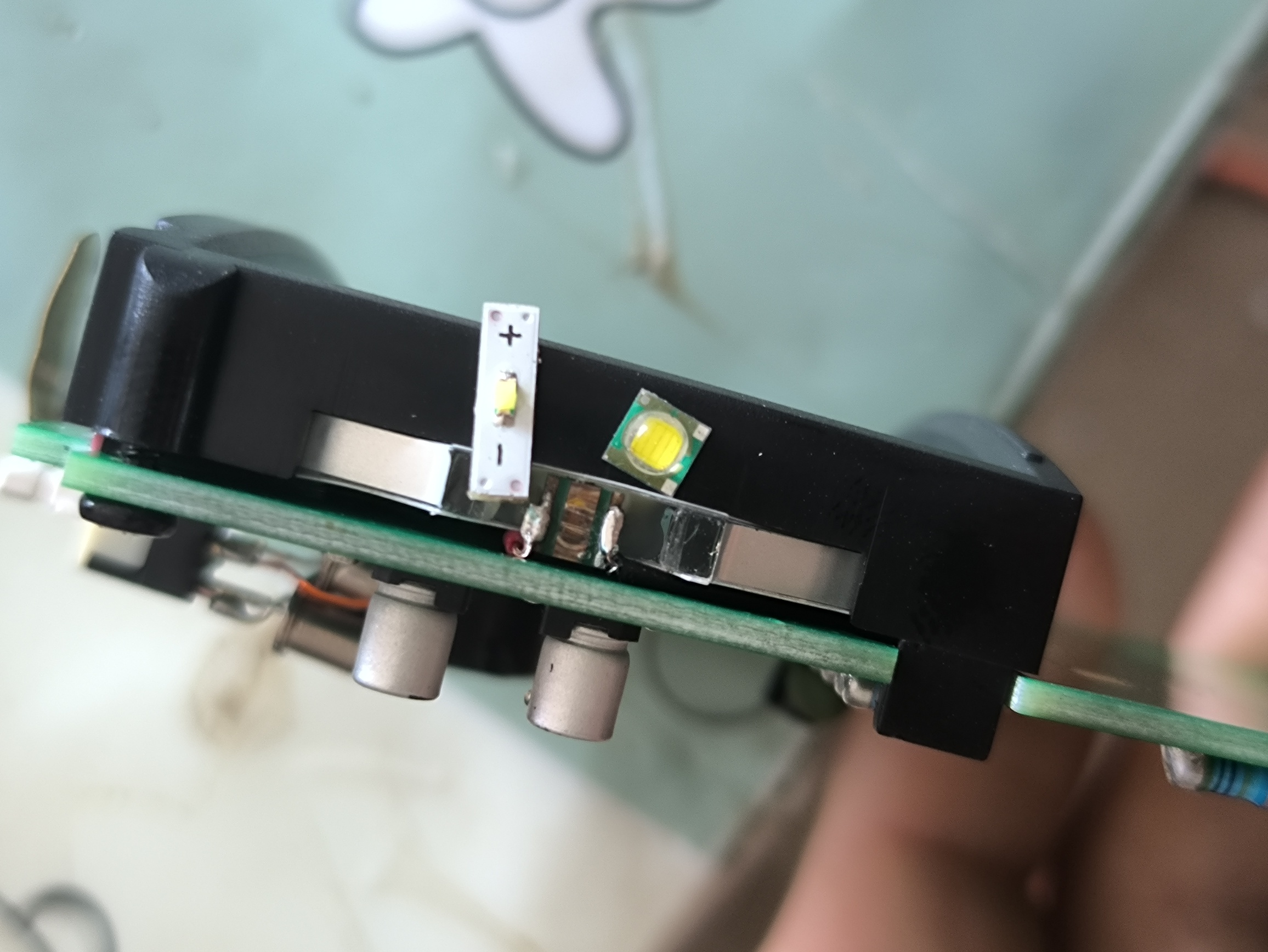

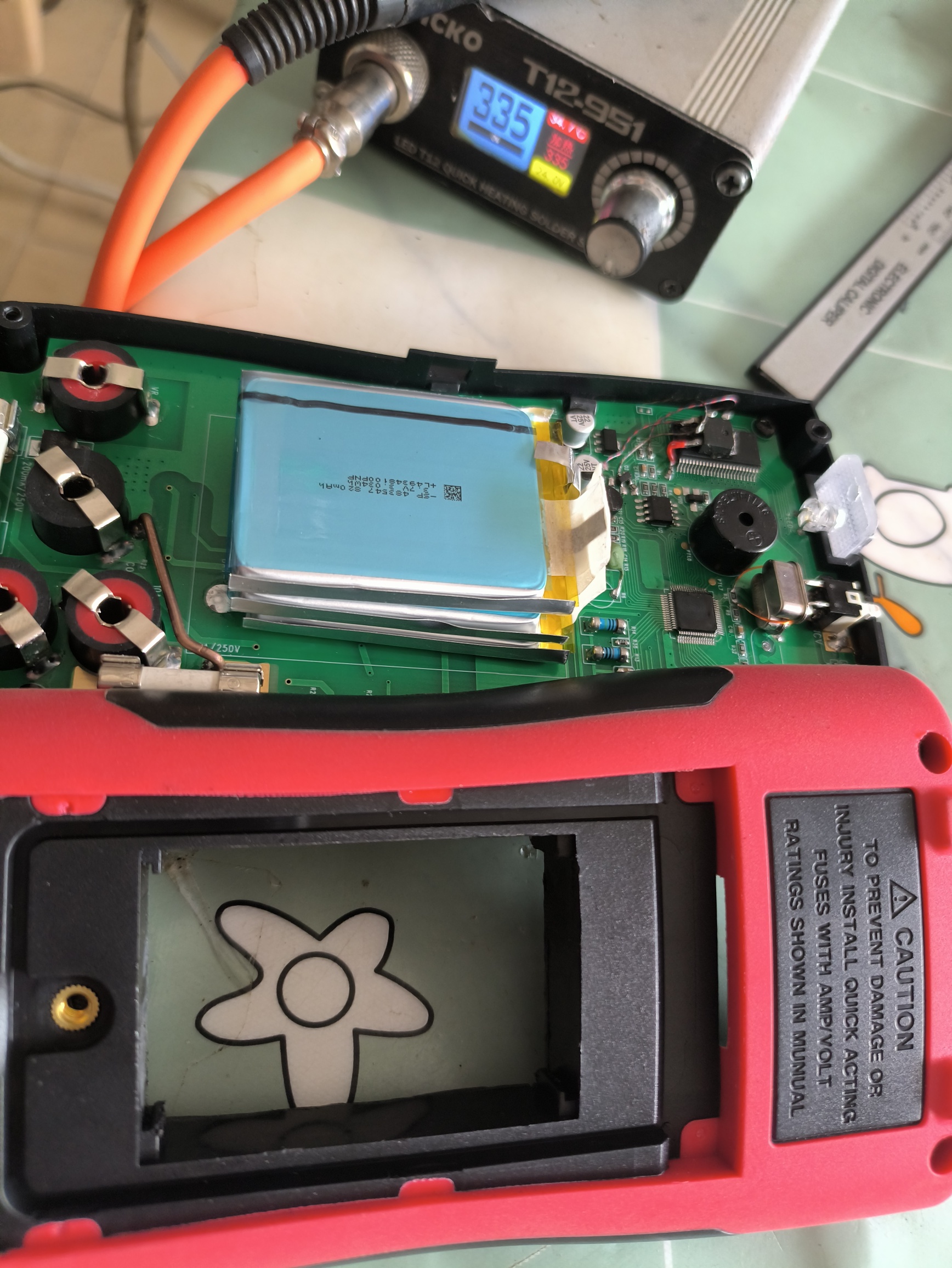

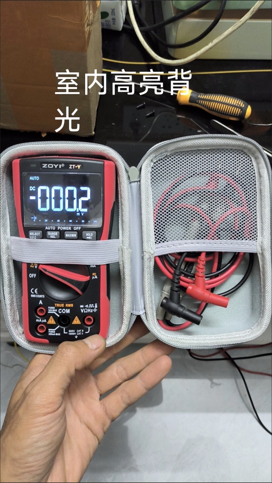

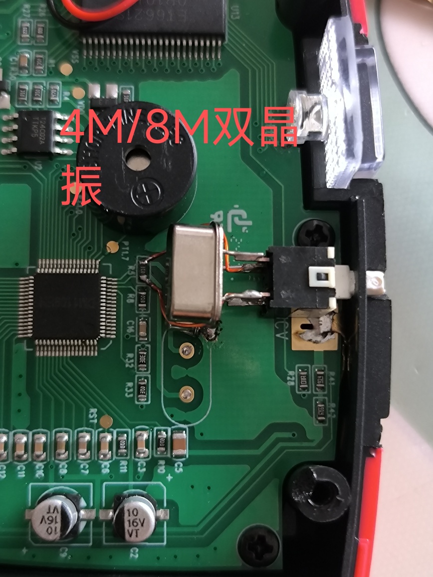

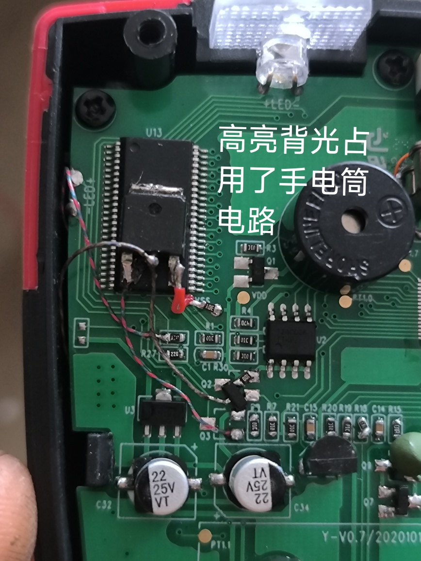

对比了219和zty,还是选zty吧,多了个功能,反显屏也无妨,改完背光后,我愿称之为阳光屏,大太阳底下读数依然清晰。
[video=http://appatt.chinafix.com/pic/20240823/1724387836082626_345.jpg]http://appatt.chinafix.com/video/20240823/1724387834743804_104.mp4[/video]
