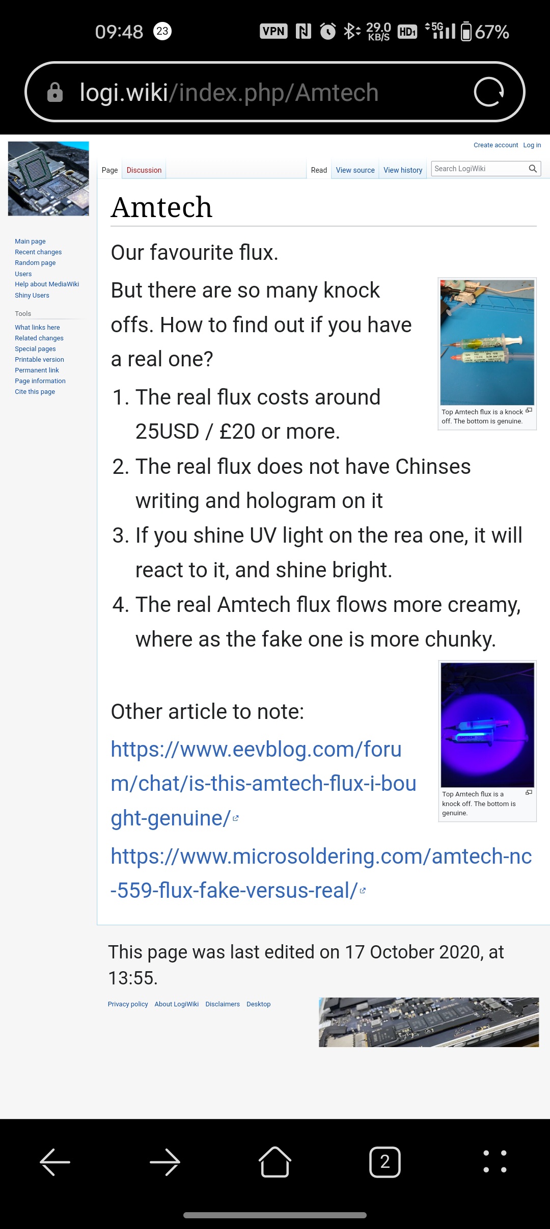

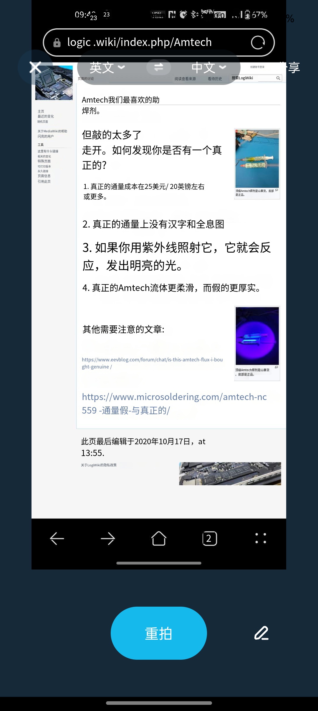

标题: 关于进口焊油的,大家琢磨琢磨一下,原文复制了
Amtech
Jump to navigationJump to search
Our favourite flux.
Top Amtech flux is a knock off. The bottom is genuine.
But there are so many knock offs. How to find out if you have a real one?
The real flux costs around 25USD / 20 or more.
The real flux does not have Chinses writing and hologram on it
If you shine UV light on the rea one, it will react to it, and shine bright.
The real Amtech flux flows more creamy, where as the fake one is more chunky
