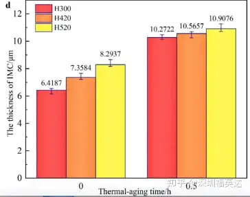

After aging at 230°C for 0.5 h, the IMC thicknesses of H300, H400, and H520 solder joints were 6.419μm, 7.358μm and 8.294μm, respectively, and the corresponding copper pad consumptions were 3.691μm, 4.069μm and 4.553μm, respectively. It can be seen that the higher the solder joint height, the larger the IMC thickness, and the more copper atoms are consumed.
Atoms diffused faster under tension with greater solder joint height. H300 was in a state of compression during reflow, while H400 and H520 were higher and in tension. Therefore, for the H520 solder joint, the diffusion speed of Cu atoms from the pad to the solder is the fastest, and the thickness of the interface IMC was the largest.
                           Figure 2. IMC thickness of solder joints with different heights.
When thermal aging at 230°C for 0.5h, Cu6Sn5 remained solid (the melting point of Cu6Sn5 is 415°C). Therefore, Cu and Sn atoms experienced longer distance solid diffusion on the IMC layer for higher solder joints. Due to the longer diffusion distance, fewer Cu and Sn atoms diffused in the higher SAC305 solder joints after the same diffusion time. In addition, due to the increase in the solder joint height, there were more Cu atoms in the solder. As a result, the concentration gradient between the solder pad and the solder of the high solder joint was smaller, and the atomic diffusion driving force was reduced. Therefore, the interfacial IMC layer growth rate and the Cu pad consumption rate decreased with the increase in the solder joint height.
