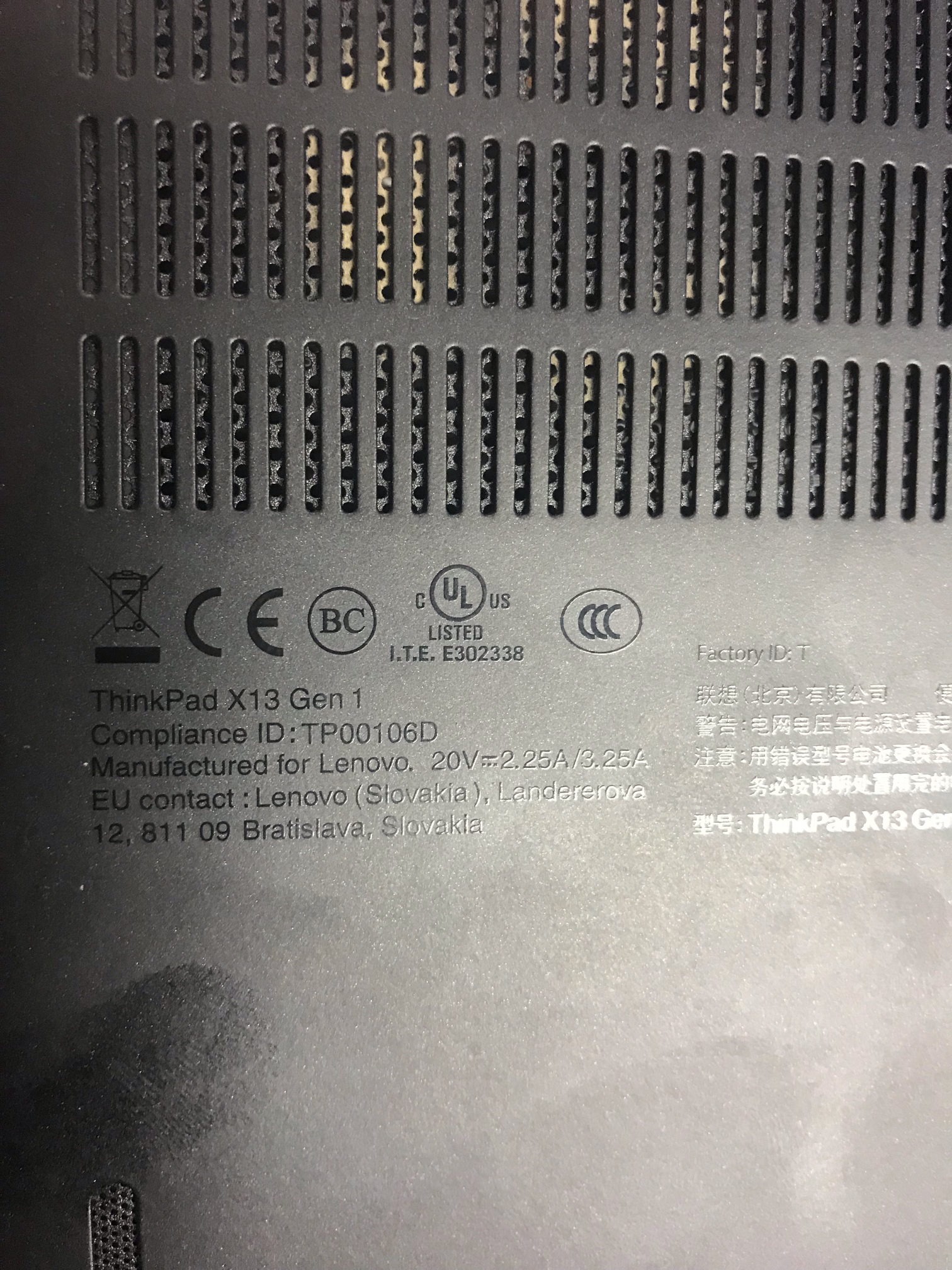

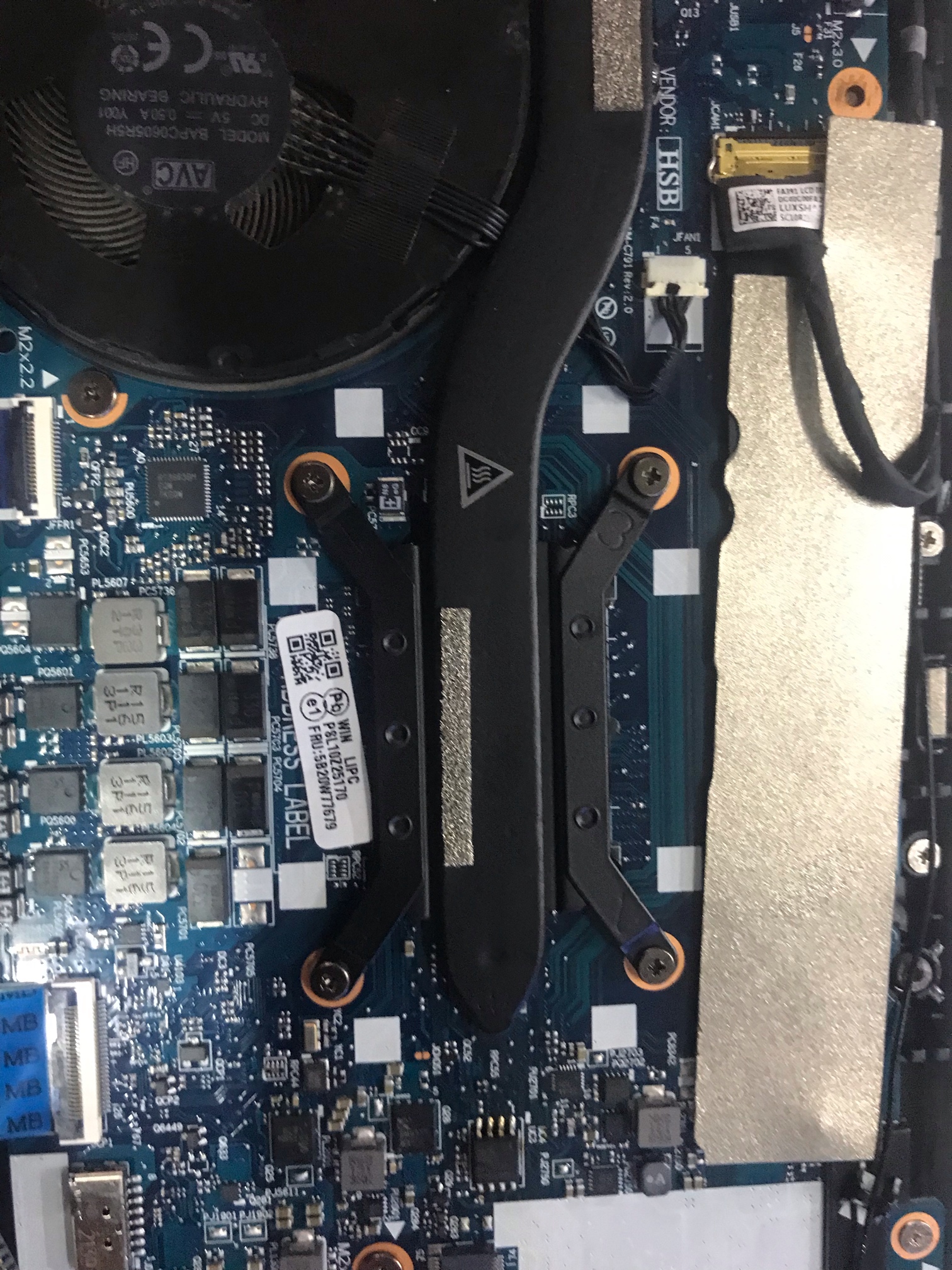

开机不显示,电流卡0.54 刷bios解决
www.chinafix.com迅维网_联想x13gen1NM-C791.BIN
