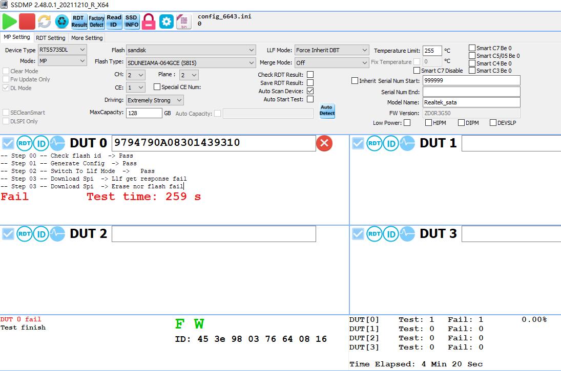

What is the problem?[attach]2223418[/attach]
作者: u1475535    时间: 2023-8-30 15:00
VXCZFFaU 发表于 2023-08-11 20:54
show me why not work or failed

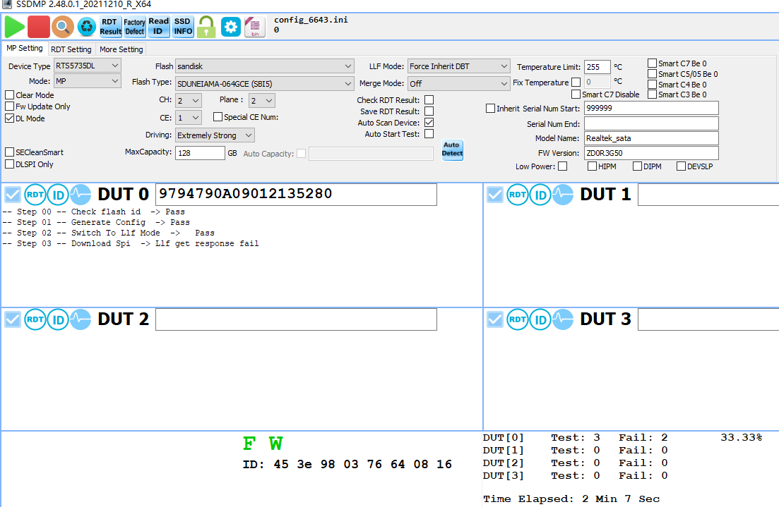

作者: VXCZFFaU    时间: 2023-8-30 17:30
u1475535 发表于 2023-8-30 15:00
remove or untag DL MODE and try againt

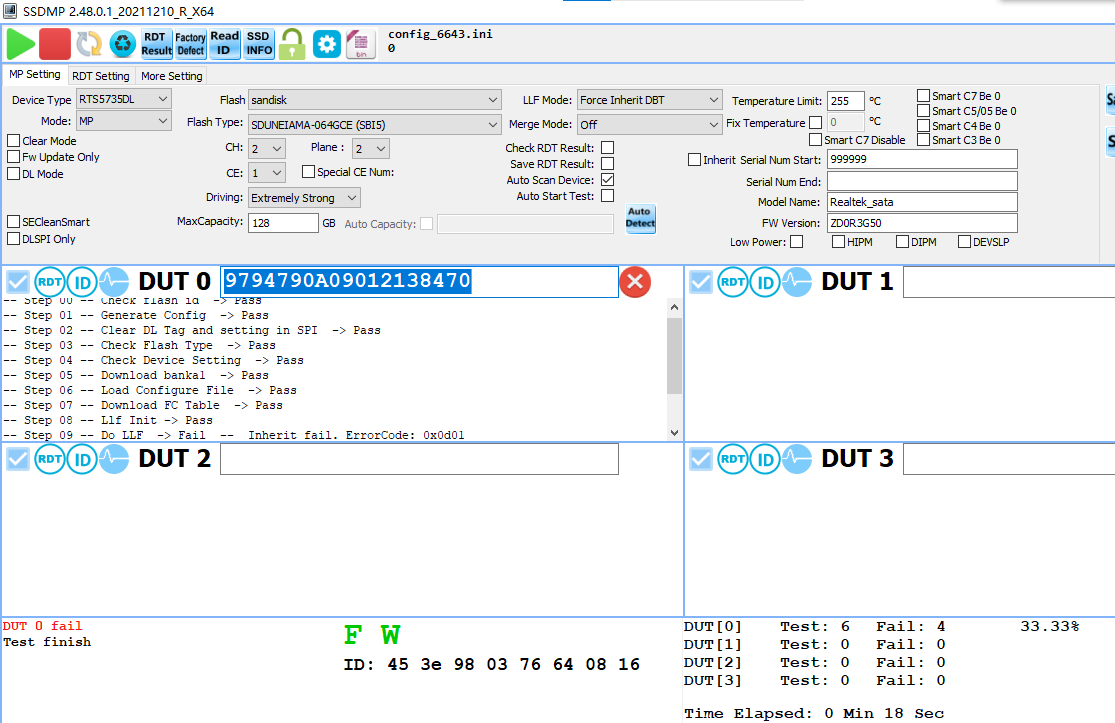

Another problem has arisen.
作者: VXCZFFaU    时间: 2023-8-31 02:05

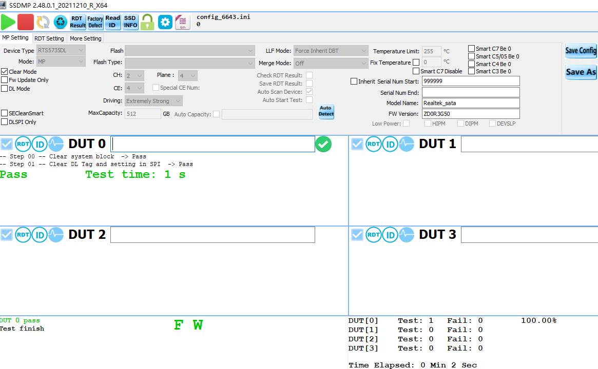

Change LLF mode to Clear All
作者: u1475535    时间: 2023-9-1 21:40
Successfully cleared, but……

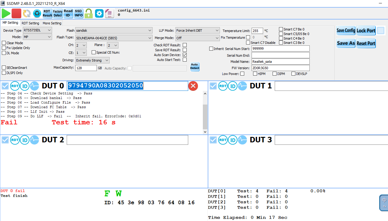

The previous two situations will still occur.
作者: VXCZFFaU    时间: 2023-9-1 22:10
Hapus atau kosongkan DL MODErubah Mode LLF untuk MENGHAPUS SEMUA
作者: u1475535    时间: 2023-9-4 00:20
Clearing successful, but attempting again failed.
