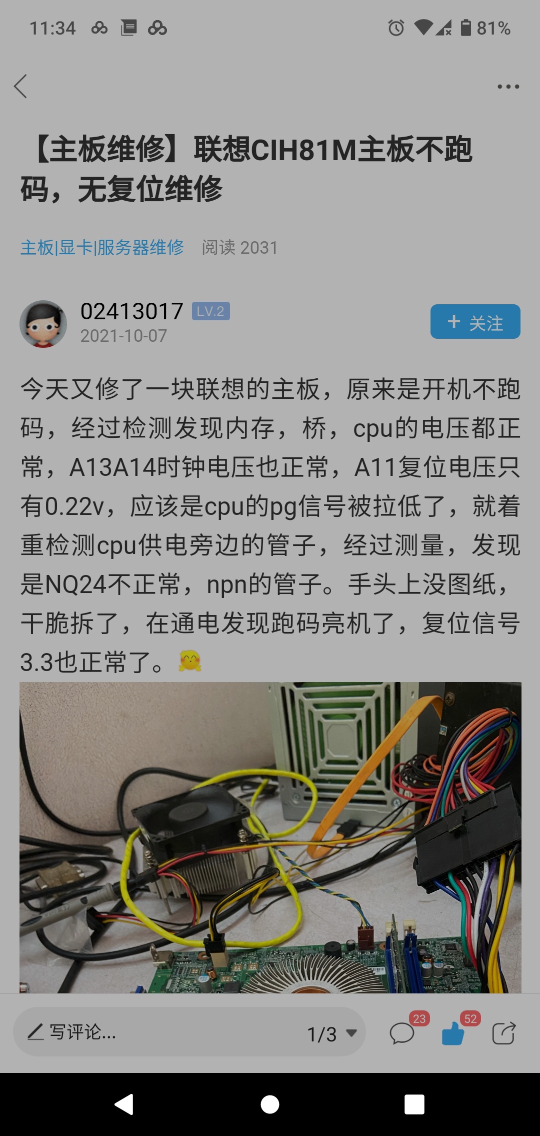

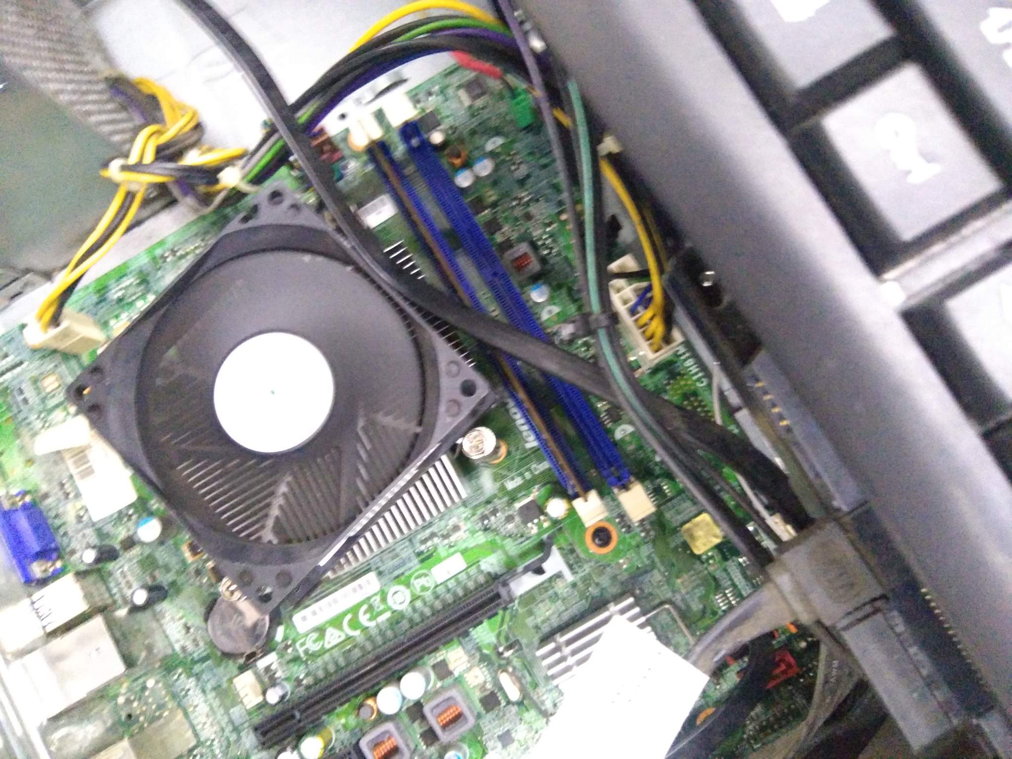

按照楼主的办法,一拆就好
作者: 别问我是谁哦    时间: 2022-6-6 11:38
https://appapi.chinafix.com/mag/circle/v1/forum/threadWapPage?tid=1292383&themecolor=f30c5c&circle_id=128&p_u=1214115
