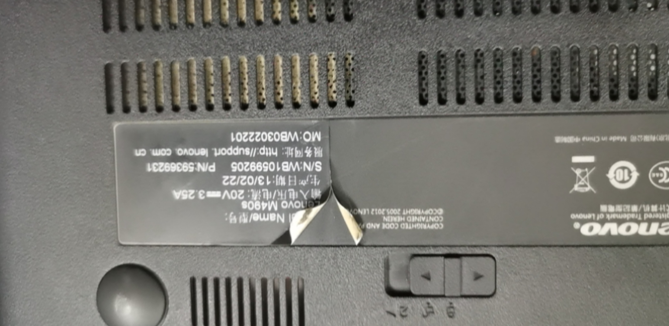

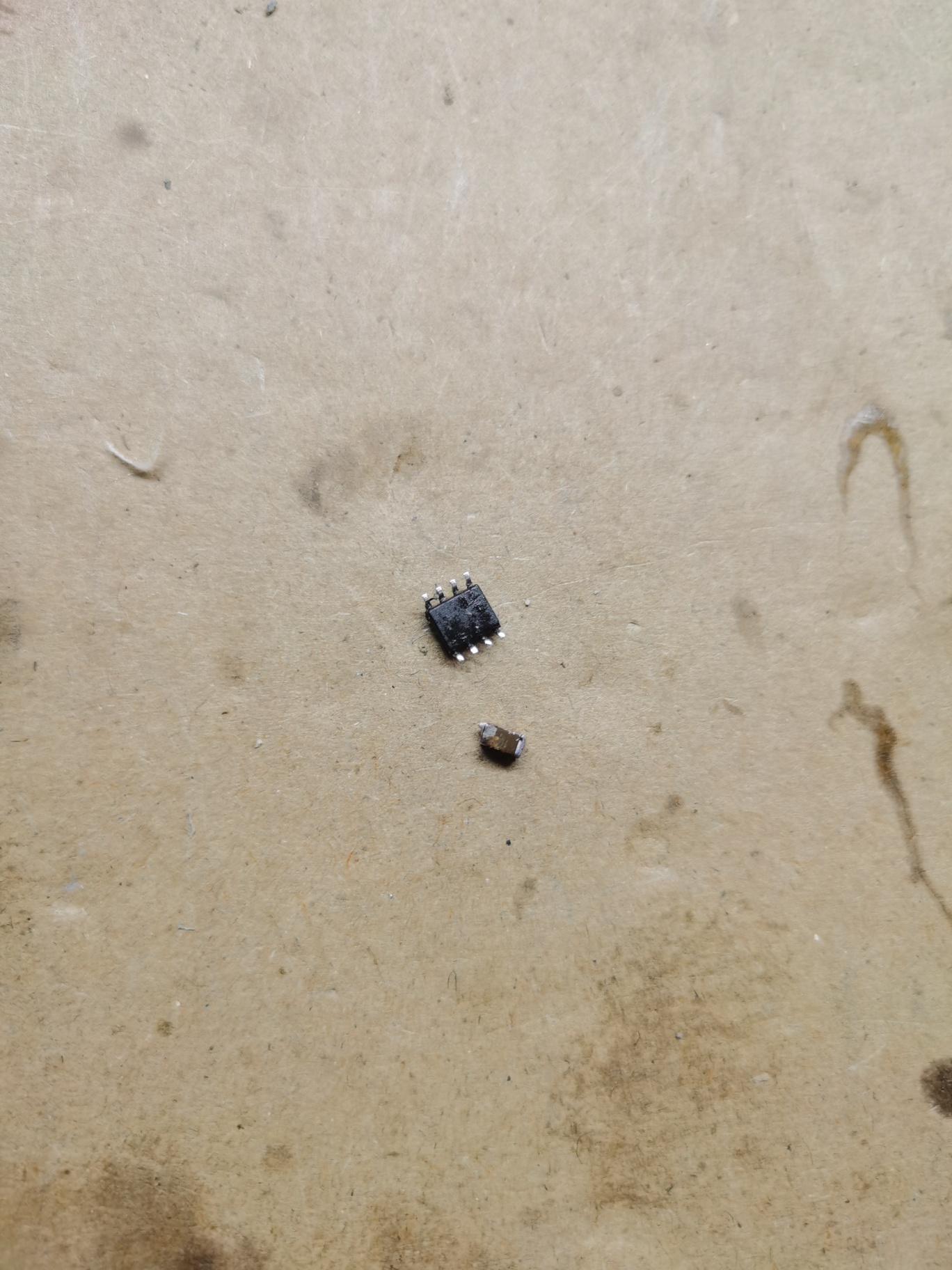

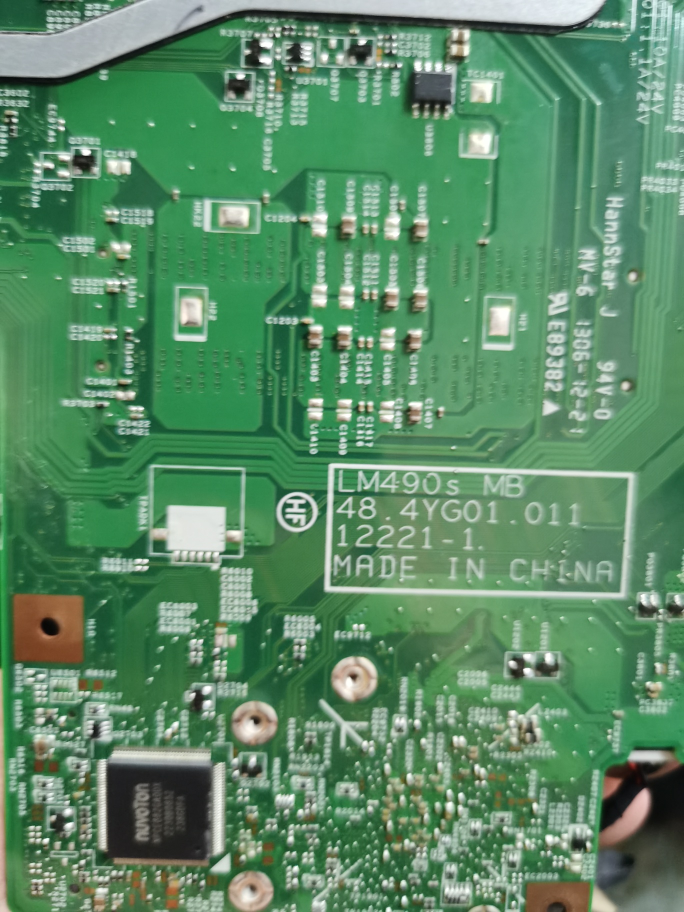

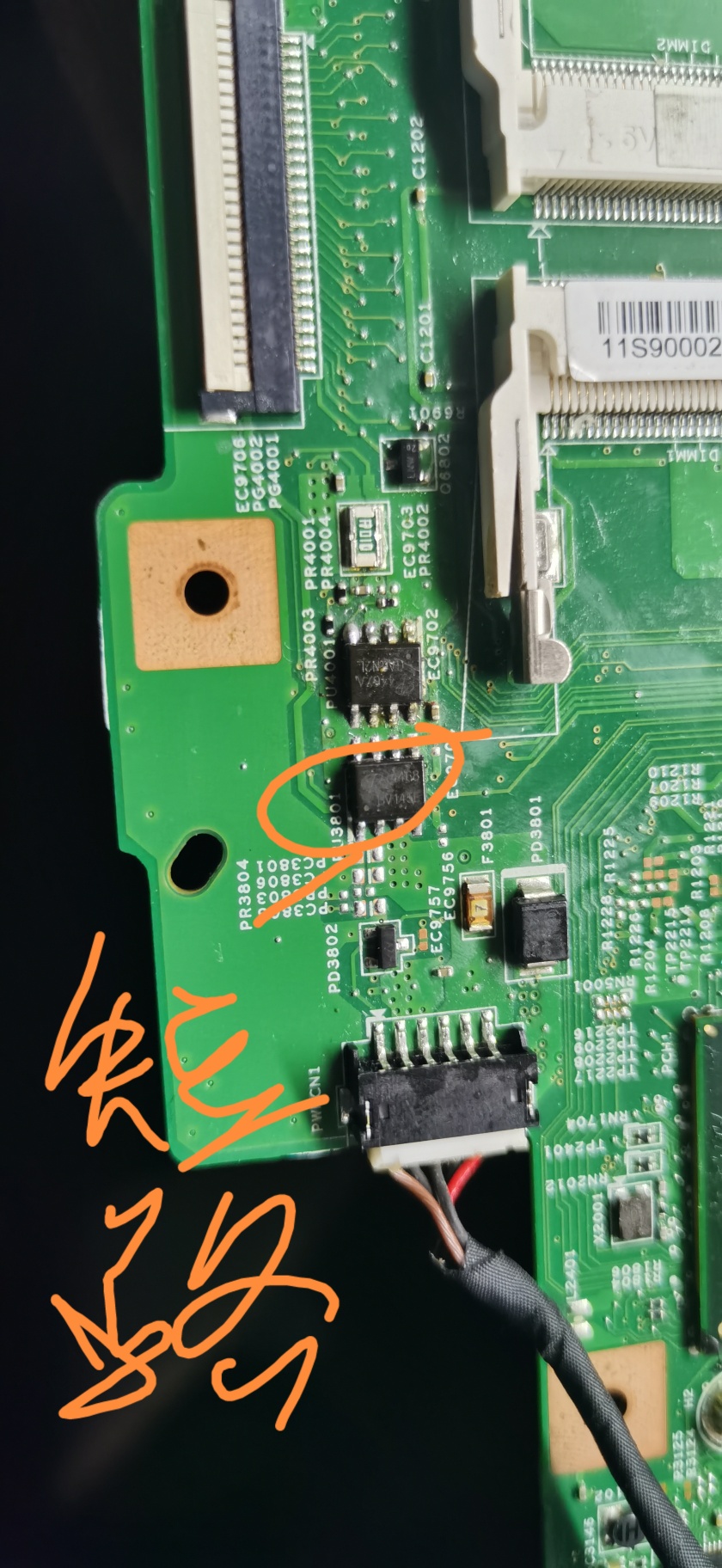

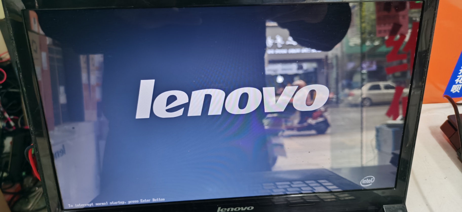

标题: 联想M490S板号LM490SMB,19V短路
