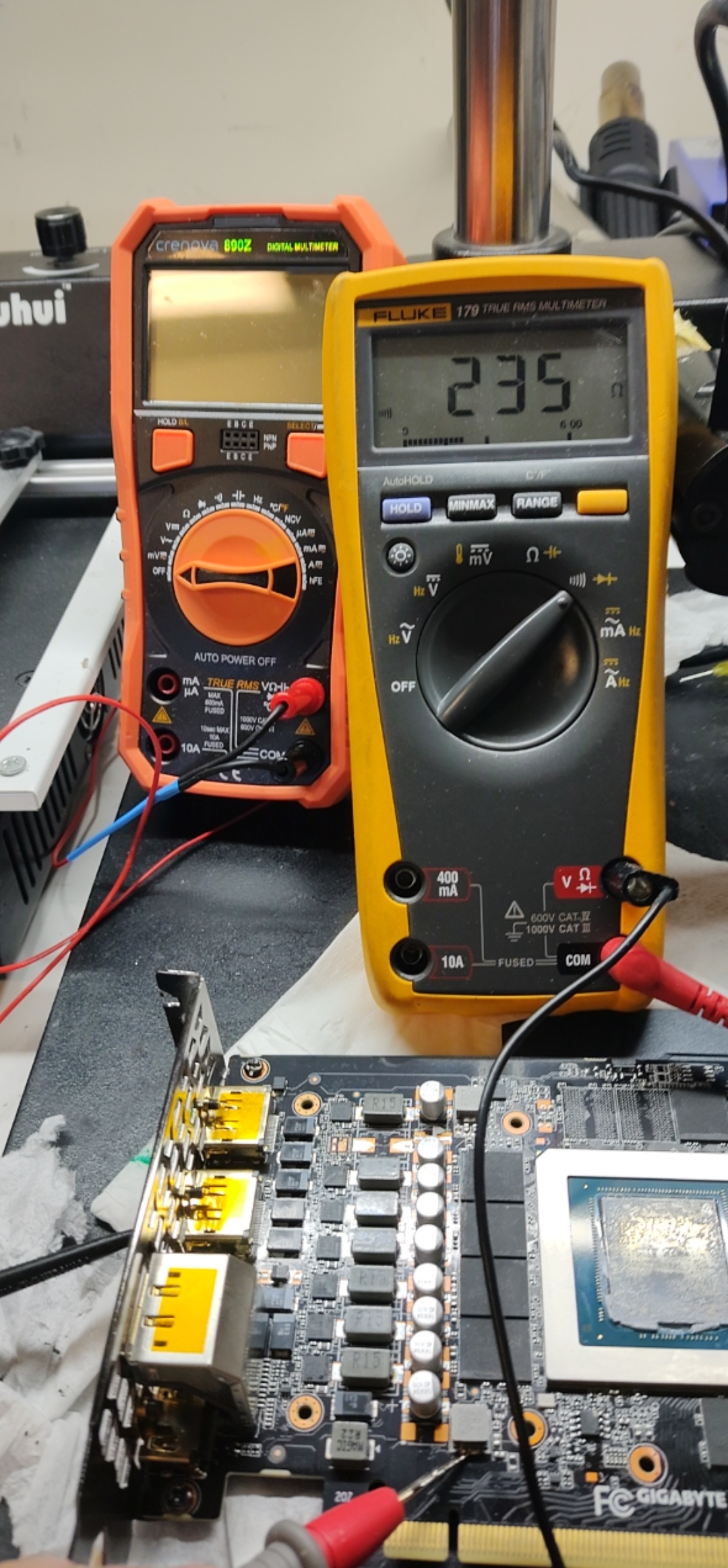

PEX_RST_BUF
When I measure the reset signal in diode mode, it shows no value.
I also checked my 3090. 1.8 rail measures 230 ohm in reverse diode. I also checked PEX_RST_BUF*, it reads 293ohm in reverse diode.
It sounds like your RST signal got desoldered on the GPU side. I would reball the GPU if I were you. Good luck!

作者: Poko    时间: 2022-3-13 03:14
vusalcrm 发表于 2022-03-12 19:13
293ohm in reverse diode. - I did not fully understand this measure. Can you explain a little bit?
maybe it doesn't belong to this topic, but i can't solve the logic of using diode mode with dmm. Is the value 0.400mv a voltage value applied to the line there?
This is what I meant.
