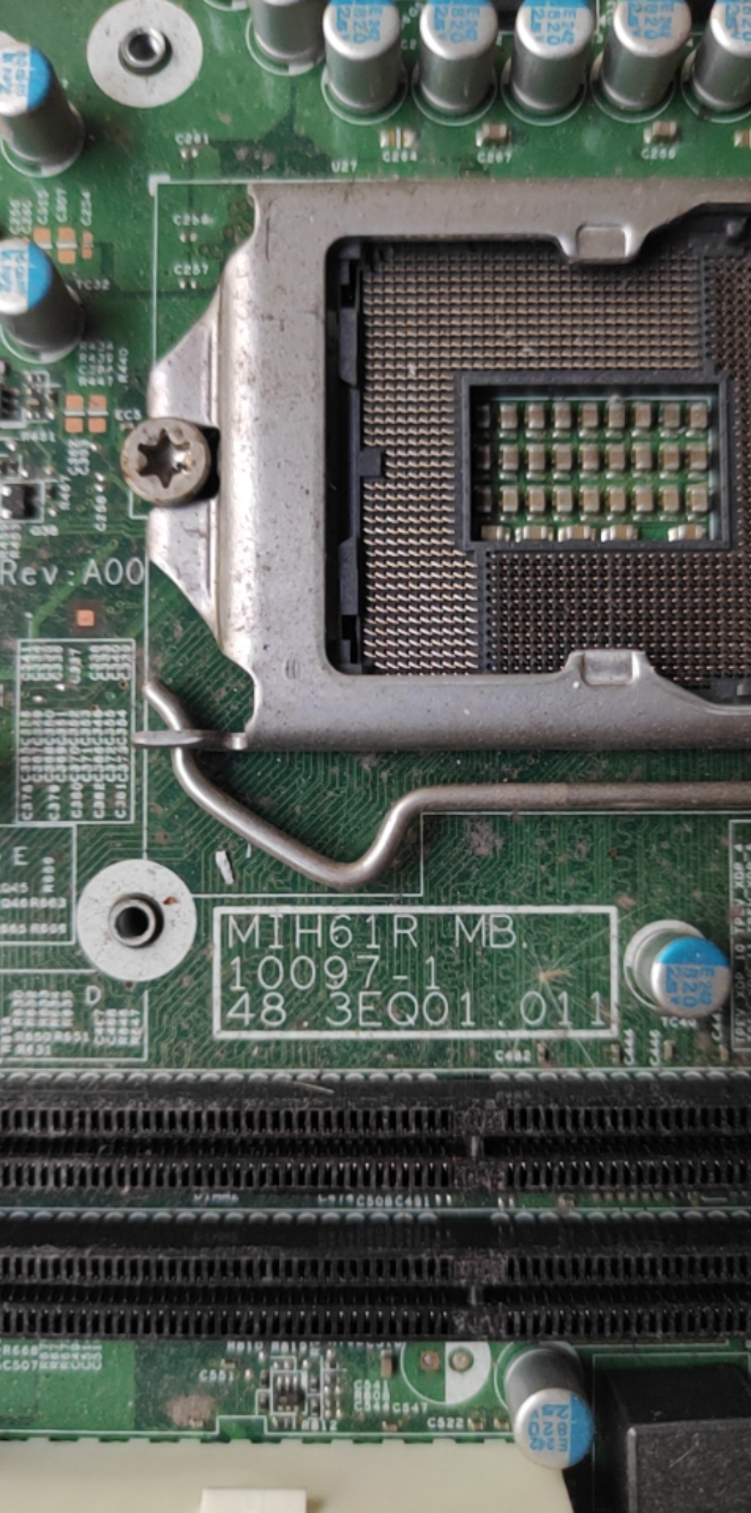

标题: Anyone has Dell MIH61R motherboard schematic diagram [打印本页]
作者: themakers2907    时间: 2021-9-5 10:50
标题: Anyone has Dell MIH61R motherboard schematic diagram
Hi,
Im trying to find the schematic for the Dell MIH61R. It just bootloops. I couldnt find the circuit diagram anywhere on this fourm. Does anyone have it? thanks.
作者: 老吴来了    时间: 2021-9-14 14:15
Dell H61主板点位图吗?我也需要,谁有哪
作者: rock959    时间: 2021-9-14 15:16
支持一下 我选择我喜欢
作者: 老吴来了    时间: 2021-9-14 18:42
这个主板我找了一天没看到开关标记。
作者: 老吴来了    时间: 2021-9-14 18:45
https://appapi.chinafix.com/mag/circle/v1/forum/threadWapPage?tid=1285586&themecolor=f30c5c&circle_id=128&p_u=1253956
