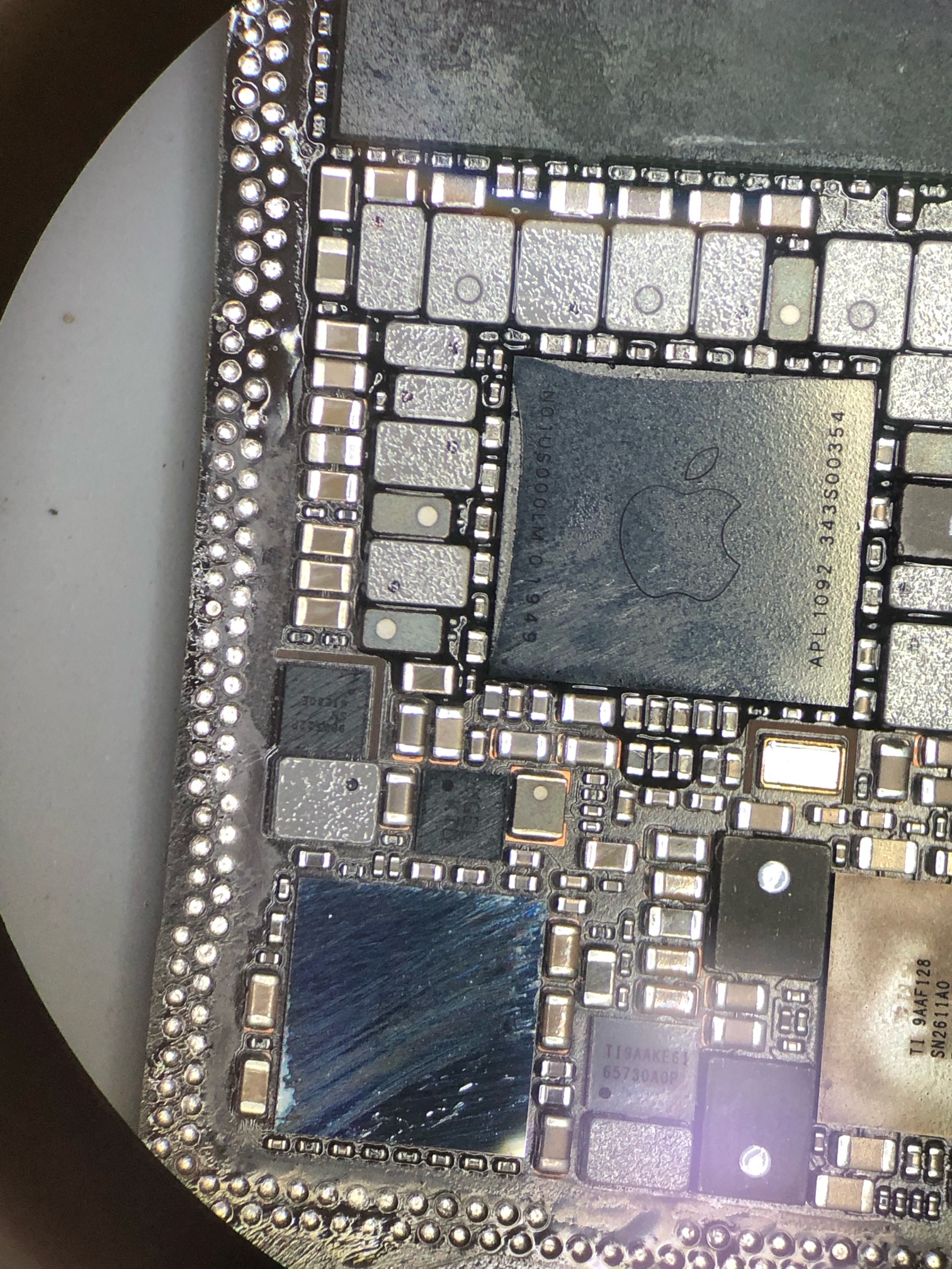

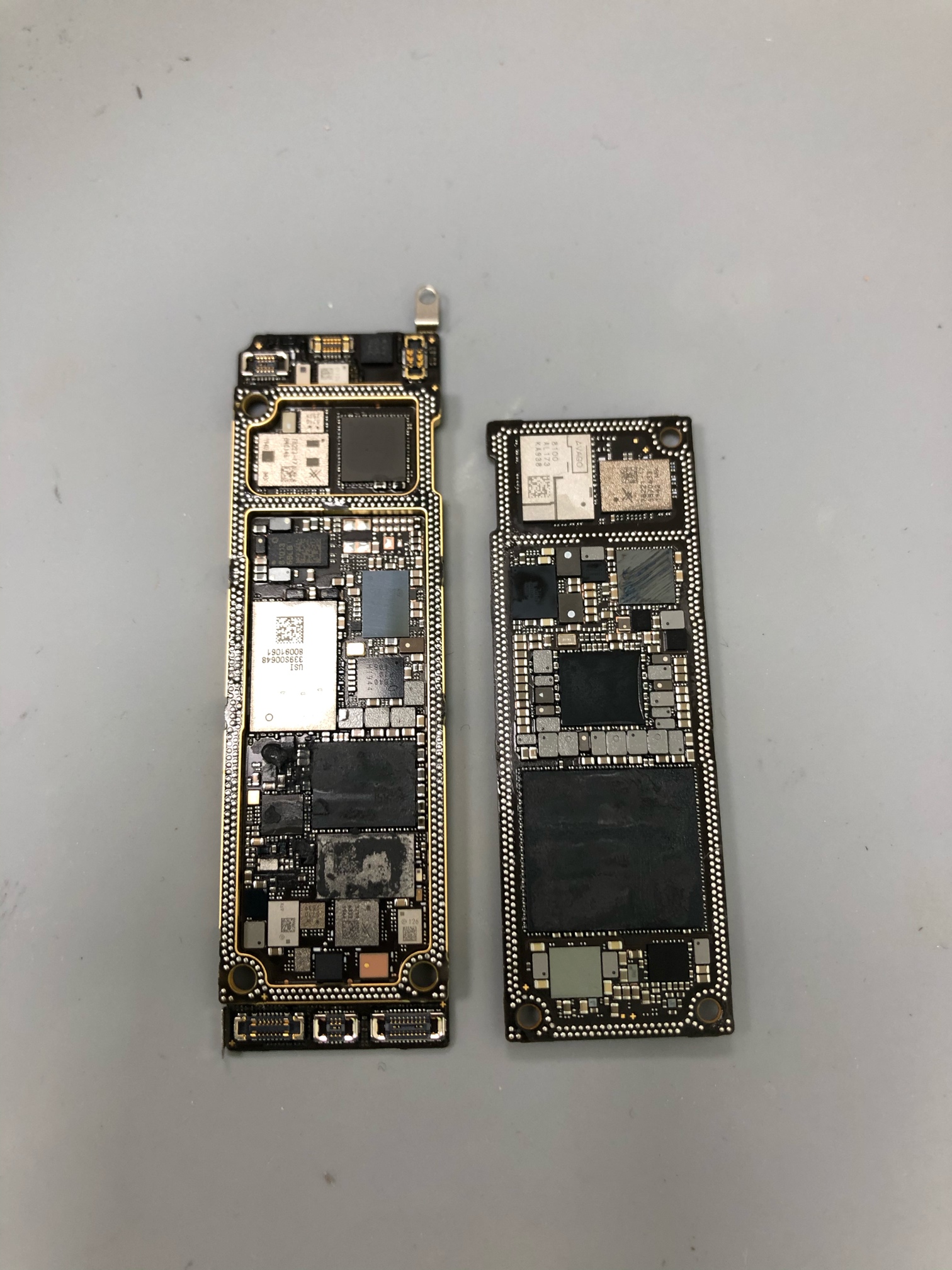

加电漏电1a多,触摸主板发现双层内部短路,进行分层,再次加点,发现是boost电容短路,发热位置熏上松香,找出问题电容,扣掉,上电不漏,开机正常,贴合起来装机,维修完毕
[video=http://appatt.chinafix.com/pic/20210817/1629187630452165624.jpg]http://appatt.chinafix.com/video/20210817/1629187630452013215.mp4[/video]
