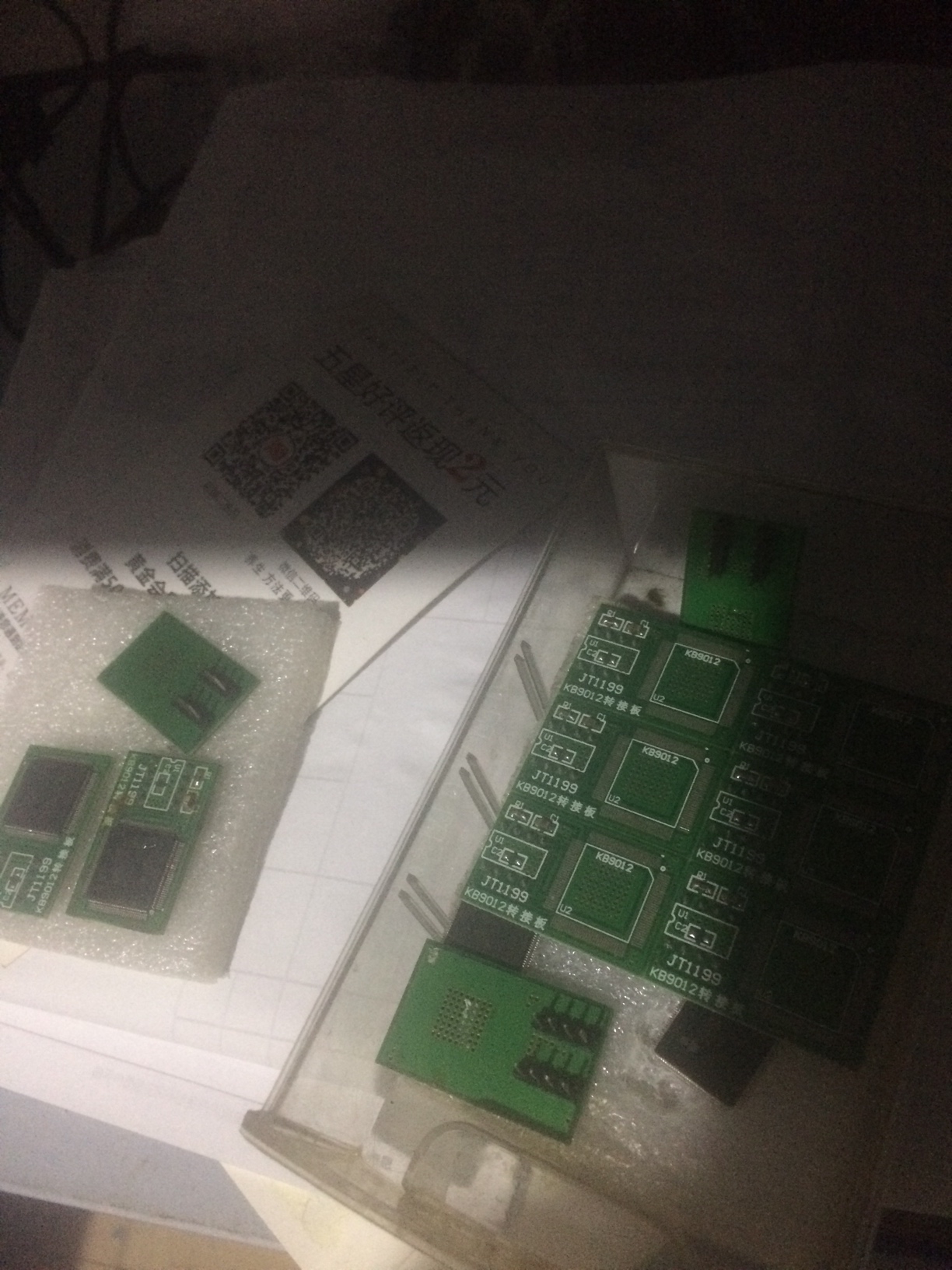

[size=13.3333px]friends
[size=13.3333px]I want to install APT10 LA-C021P REV-1.0 kbc, but my
[size=13.3333px]programmer does not have this model, which option can I install?
[size=13.3333px]Vertyanov JIG ver 4.B
[size=13.3333px]kb9012qf 4a how to tie
[size=13.3333px]thanks

作者: H55    时间: 2020-12-3 17:29
用这种焊接刷!你那个需要有键盘接口调整!这种才几块钱一个,方便
作者: asliyucegsm    时间: 2020-12-8 20:05
kbc9012 asked uploaded connected and solved this way
LA-C021P KSO3=7 KSI4=16 KSI7=13 KSI6=24 KSI5=17
Thank you for your interest
