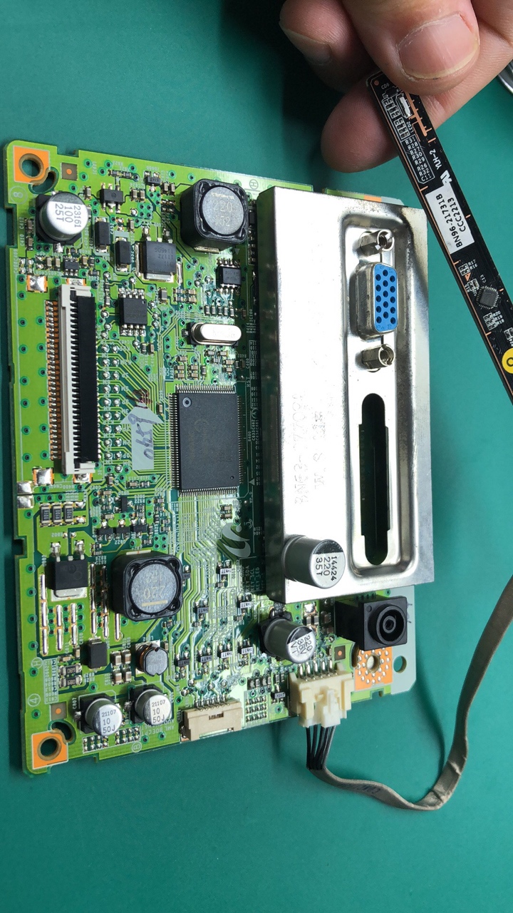

触摸显示器没有开机反应,拆机万用表测量主控板,发现220if/35v高压电容不稳定,淘宝订货更换,触摸灯正常开起!
[video=http://appatt.chinafix.com/pic/20200715/1594827700455577226.jpg]http://appatt.chinafix.com/video/20200715/1594827700455479337.mp4[/video]
