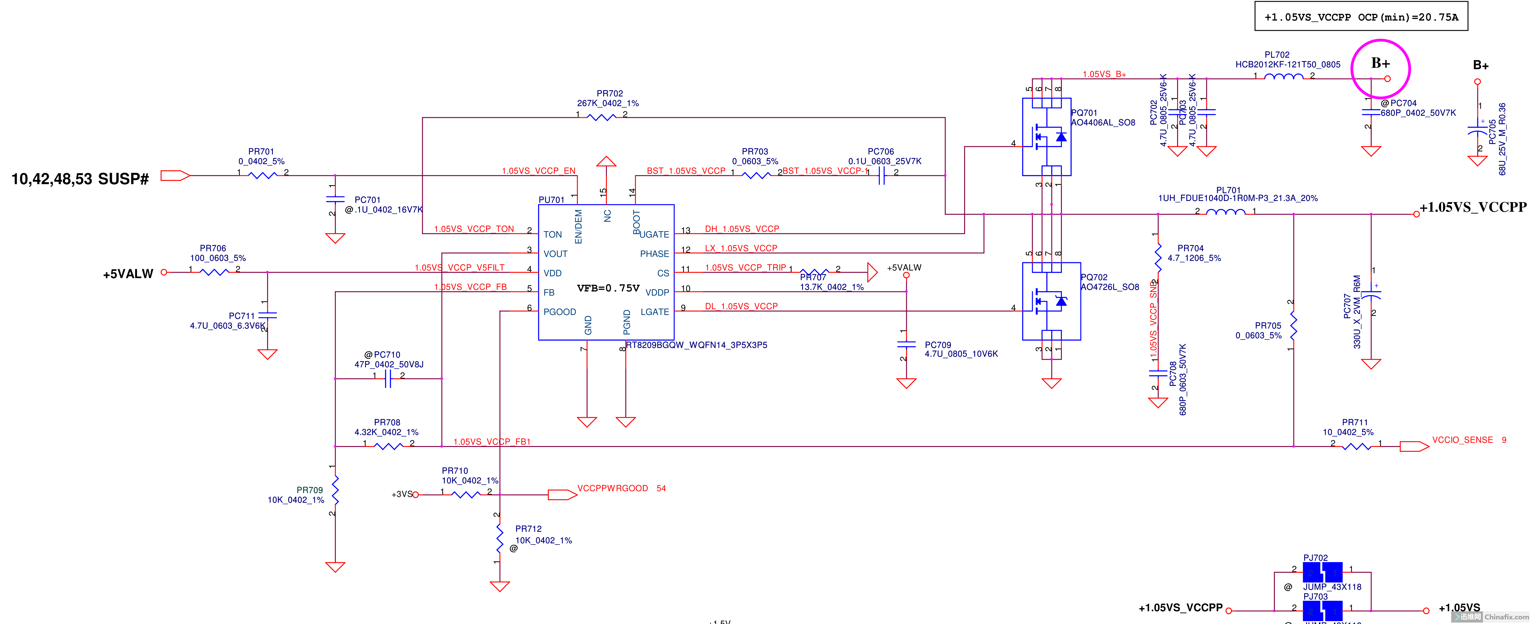

补充内容 (2020-5-31 19:27):
OP=  RT8813
https://ftp.chinafix.com/forum/2 ... y6iyi7pvy7kjdss.png

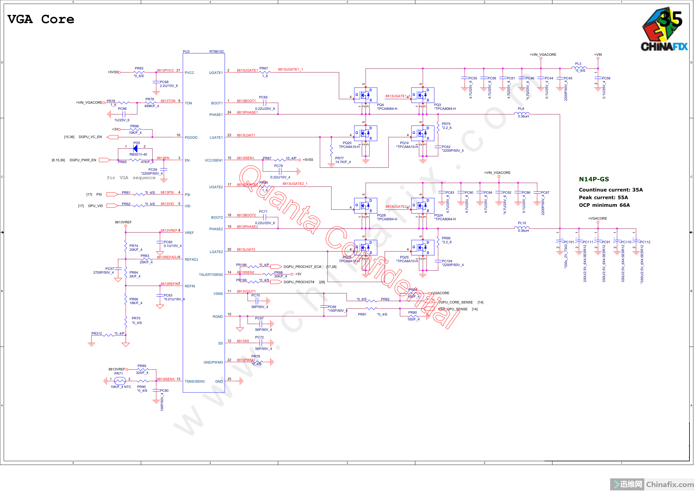

补充内容 (2020-6-3 15:23):
A8=  RT8209B
应用图:https://ftp.chinafix.com/forum/2 ... i26sc6j2giqlciq.png
参考图纸:LA-6884P

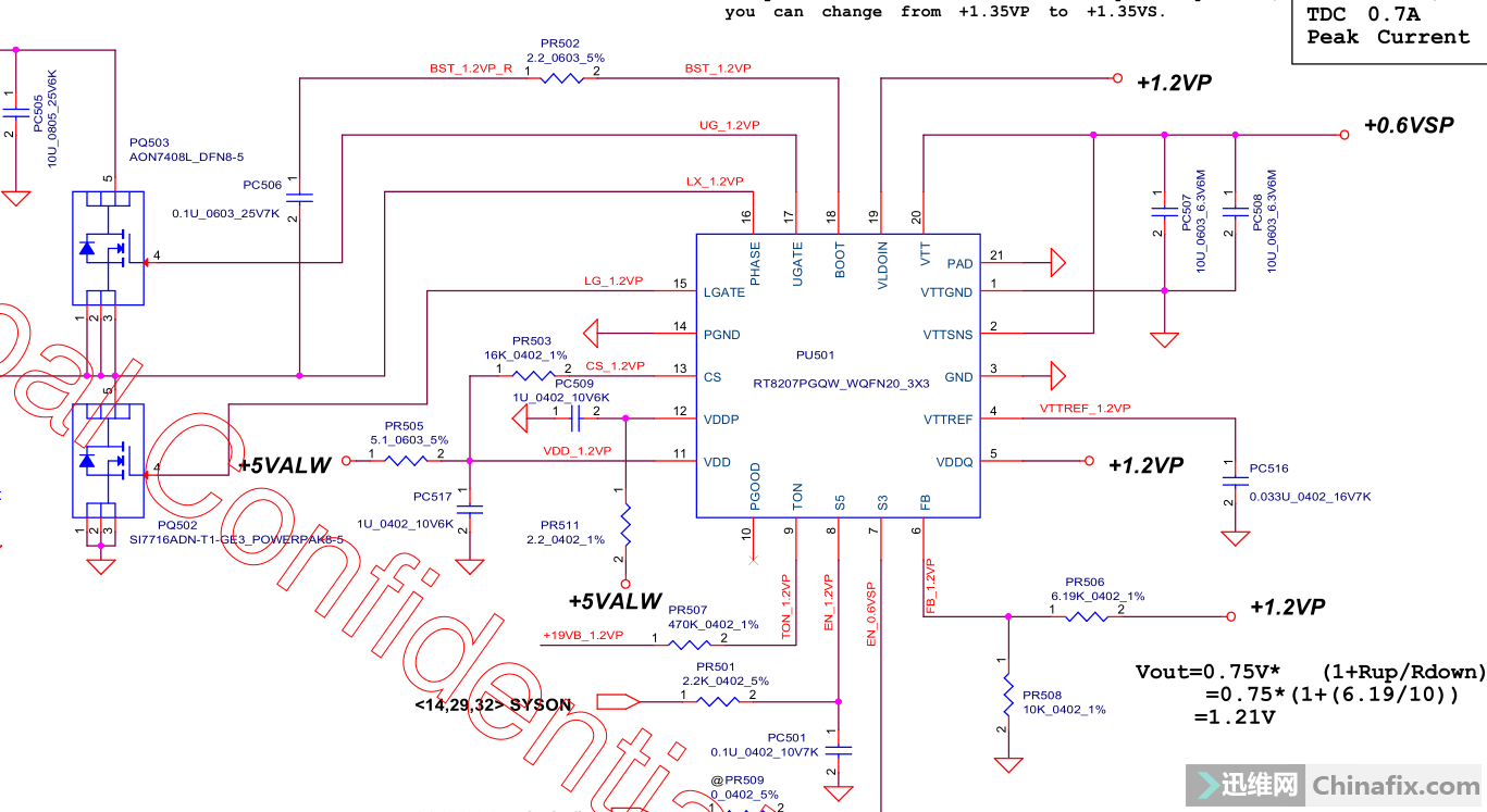

补充内容 (2020-6-25 11:34):
48= 可用RT8207P代换
脚位应用图:https://ftp.chinafix.com/forum/2 ... p068jos996c5pu0.png
来源:https://www.chinafix.com/thread-1159325-1-1.html

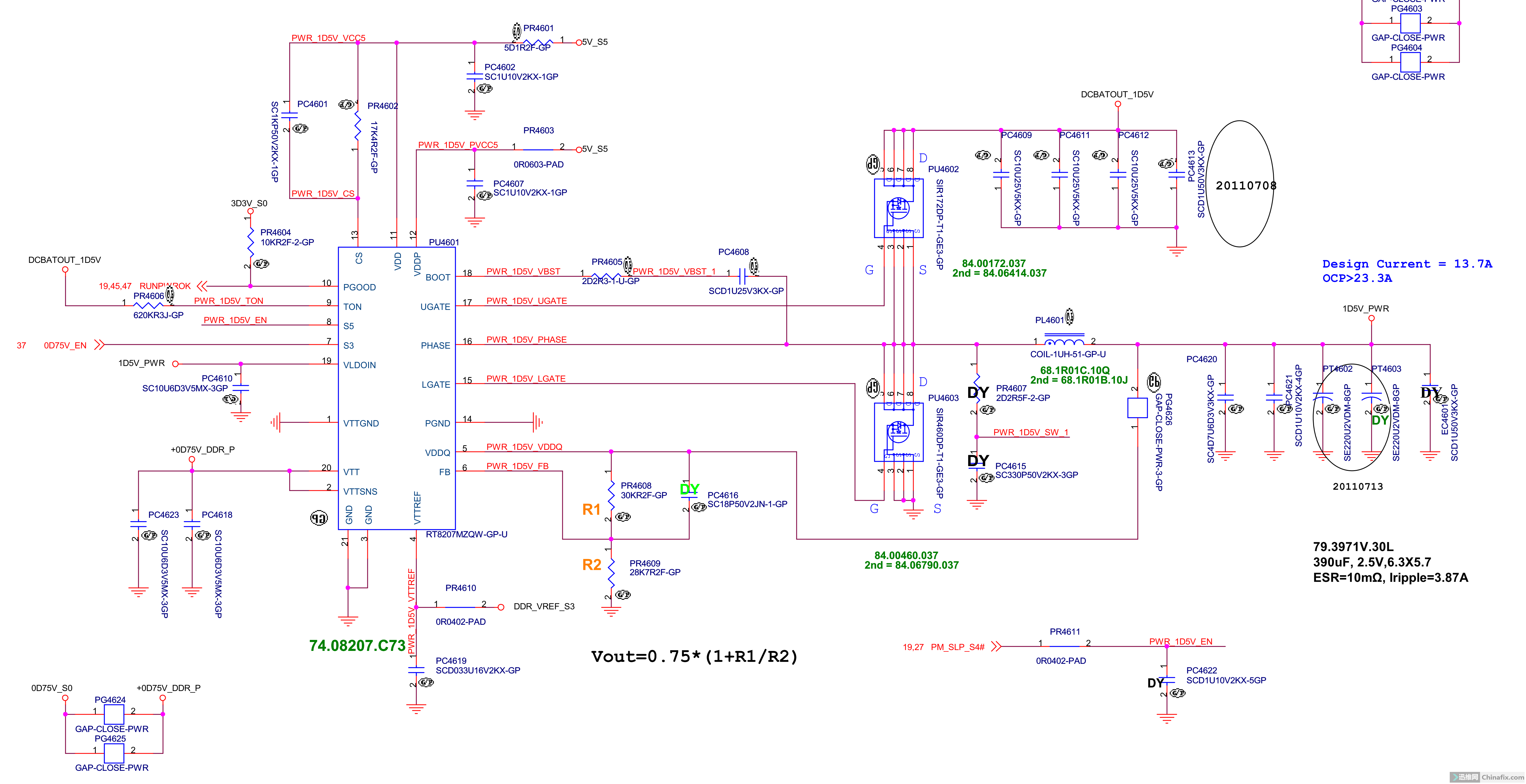

补充内容 (2020-6-25 11:36):
RT8207P参考图纸:https://wwe.lanzous.com/isEsle0my7c

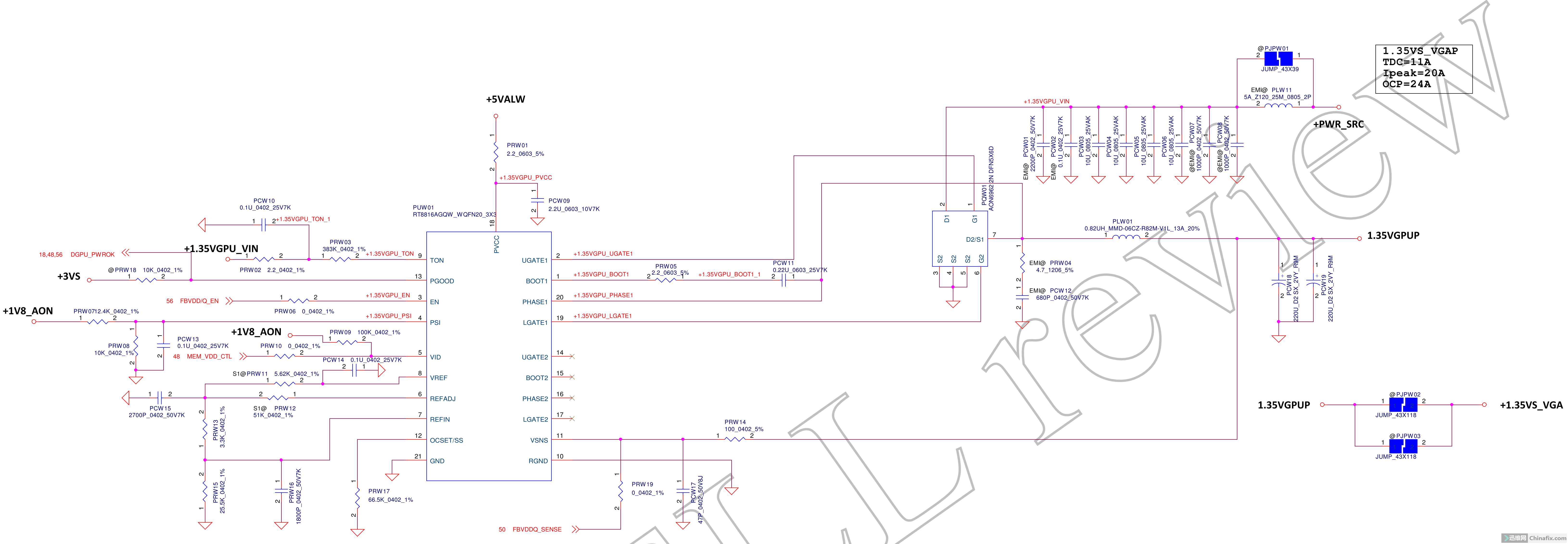

补充内容 (2020-6-25 14:08):
7J=  RT8816A
脚位图:https://ftp.chinafix.com/forum/2 ... h7p5quwzbduuhzp.png
