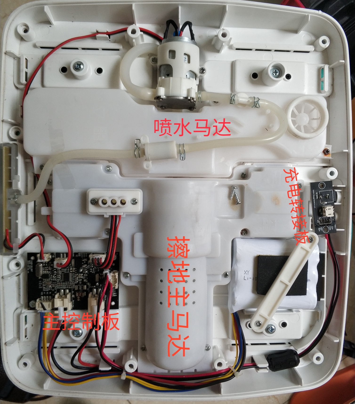

ÍϵØÍ¦À۵ģ¬ÂòÁ˸öСÃ×È÷ÍÛµØßÇÊÖ³Öʽ²ÁµØ»ú£¬ÕâÑù×ÓʡЩÁ¦Ã»ÄÇôÀÛ¡£
µÇ¼/×¢²áºó¿´¸ßÇå´óͼ

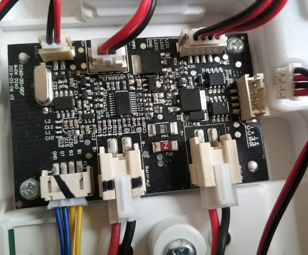

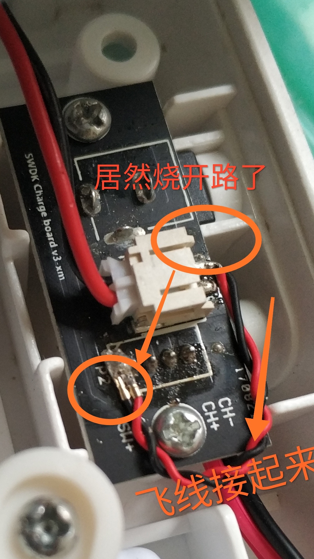

ÓÃÒ»¶Îʱ¼ä¾Í²»¶¯ÁË£¬Ê×ÏÈ»³ÒÉÊÖ±úÒ£¿ØÆ÷ûÓеçÁË£¬²ð»úÁ¿²âµç³ØµçѹÕý³£¡£¼ÌÐø·Ñ¾ÅÅ£¶þ»¢Ö®Á¦²ð¿ª²ÁµØÖ÷»ú£¬¾­¹ýÒ»·¬Á¿²â·¢ÏÖÊdzäµç°åPCBÏß·ÉÕ¶ÏÁË£¬Ó¦¸ÃÊÇÅçË®ºø×¢Ë®Ê±²»Ð¡ÐĽøË®µ¼Ö¶Ì·ÉÕ»ú£¬·ÉÒ»¸ùÏß½«¿ªÂ·PCBº¸ÆðÀ´£¬ÊÔ»úÕý³£Æô¶¯£¬ÍϵØÈ¥¡­¡­
